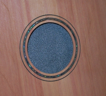

Posts: 697
Below is a picture of a rosette I just finished. I used a teflon strip and wbw & bwbw wood purflings. I had no problems except that when I went to put in the (Straight)Ablam pieces, breaking them as I went along, I had to be very careful not to break or tear the very thin maple strips thar were positioned next to the Ablam. Hope this helps.
